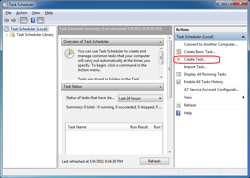

  1. Open the Task Scheduler by going to the Start Orb, All Programs, Accessories, System Tools, and open Task Scheduler.
    bypass-uac-prompts-1
  2. Click Create Task on the top right of the Task Scheduler window.

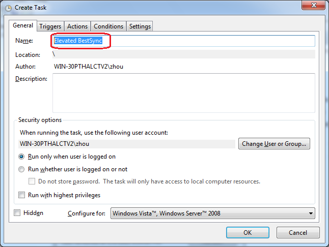

  3. Give the task a name in the Name box in the Create Task window.
    bypass-uac-prompts-2
    Take note of this name (Elevated BestSync). You'll need it later.

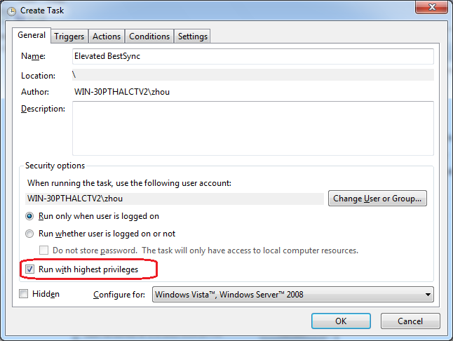

  4. Check on Run with highest privileges.
    bypass-uac-prompts-3

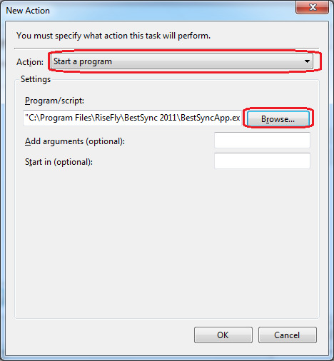

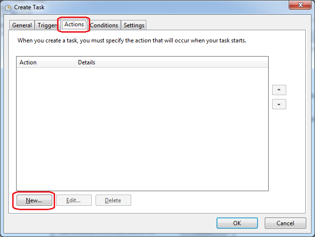

  5. Click New in the Actions tab of the Create Task window.
    bypass-uac-prompts-4
  6. Browse to the location of the BestSync Application ("C:\Program Files\RiseFly\BestSync 2012\BestSyncApp.exe") in the Program/script box and then click OK.
    bypass-uac-prompts-5

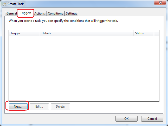

  8. Click New in the Triggers tab of the Create Task window.
    bypass-uac-prompts-6

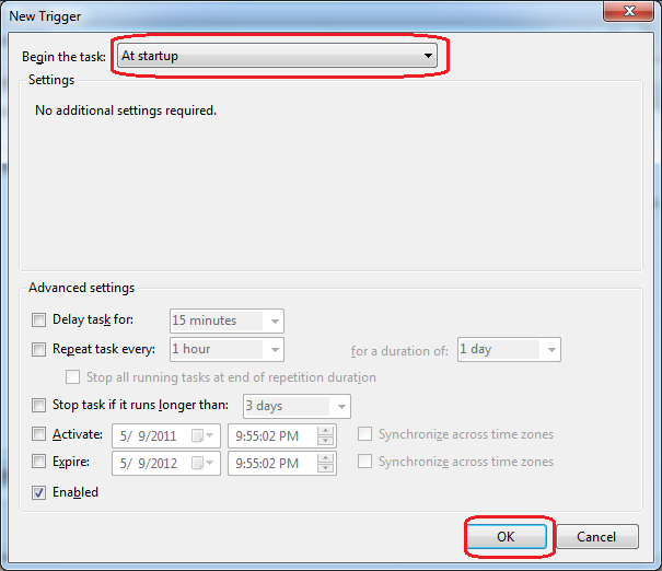

  9. Select At startup in the Begin the task combo box,  and then click OK.
    bypass-uac-prompts-7
    This way starts BestSync Application when Windows Starts.

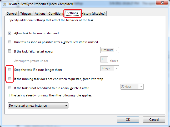

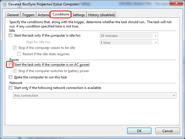

  10. Please uncheck the following settings that may affect auto-start, Click OK to end the New Action dialog box.
    bypass-uac-prompts-9
    bypass-uac-prompts-10

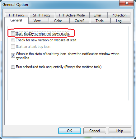

  11. Do not forget to uncheck the auto-run option in the BestSync application itself.
    bypass-uac-prompts-8
